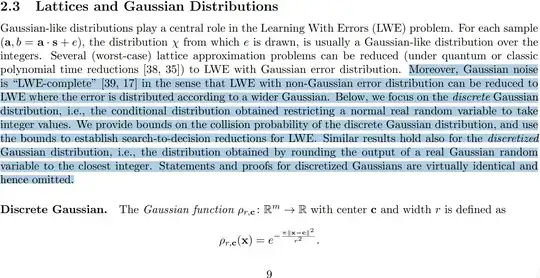

I've seen a paper that may be related to this question. In following a short paragraph of this paper, explains about $\color{blue}{discrete}$ Gaussian distribution and the $\color{blue}{discretized}$ Gaussian distribution.
Reference: [Daniele Micciancio, Petros Mol. "Pseudorandom Knapsacks and the Sample Complexity of LWE Search-to-Decision Reductions," In Crypto 2011, IACR 2011/521]
