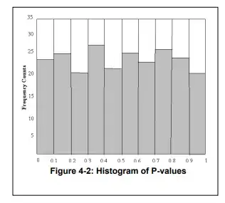

And in the document's examples, they choose α = 0.01 which is hard coded into the test suite for determining PROPORTION of pass/fails. Due to the pesky nature of randomness, the P-values should be uniformly distributed over 0 - 1, giving you a histogram like below from the C1 C2 C3 C4 C5 C6 C7 C8 C9 C10 section of finalAnalysisReport.txt:-
histogram

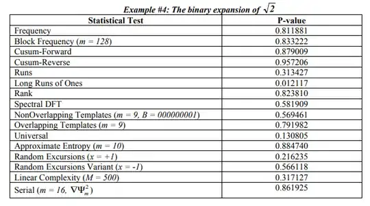

And for further comparison, the following is an extract from a 'perfect' test score on the expansion of $ \sqrt{2} $ . Like $\pi$, we know $ \sqrt{2} $ to be irrational and therefore any expansion to any base naturally creates an infinite and perfectly random sequence. God's random number generator if you will. Such numbers are commonly used as yardsticks in validating the randomness tests themselves, and inevitably you can see it passing the NIST test below:-
ps
So you see that there is a degree of black magic and experience necessary to rank a test. Typically though, when a sequence is not random, you tend to get a load of P = 0.00000 or P =1.00000 so it's more clear cut.
