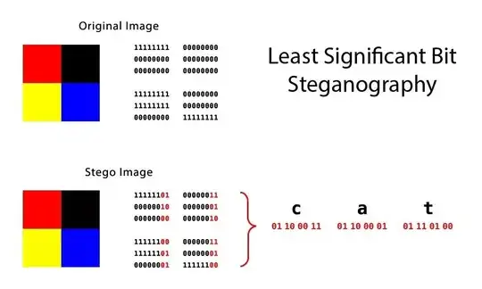

If you consider the mechanics of embedding the image in it's simplest form, then all you do is repurpose some of the existing bits. The following is a Wikipedia extract from an article on steganography:-
For example, a 24-bit bitmap uses 8 bits to represent each of the three color values (red, green, and blue) of each pixel. The blue alone has $2^8{}{}$ different levels of blue intensity. The difference between 11111111 and 11111110 in the value for blue intensity is likely to be undetectable by the human eye. Therefore, the least significant bit can be used more or less undetectably for something else other than color information. If that is repeated for the green and the red elements of each pixel as well, it is possible to encode one letter of ASCII text for every three pixels.
which kinda looks like this:-
cat
except that your message is encrypted. So the image remains exactly the same size.
The issue facing you (and your software) is how many bits can you alter and remain unnoticed? One certainly. The above example uses two and the altered image looks similar. Could you use three then? Clearly seven bits would totally destroy the image and tip off the attackers. It's a balance between leveraging the unavoidable noise introduced by the image digitisation process, the artistic scene and how dangerously you like to live.
