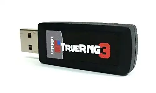

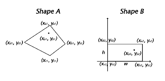

A bona fide use case for encryption only is inside a true random number generator (TRNG). If you have something small like:-
trng
it's common to whiten the raw entropy signal using a cryptographic primitive. PRESENT could be used in some form of CFB mode, although there are examples of vanilla ECB mode being used. The designers of these simple key type TRNGs often fail to appreciate the nuances of modes of operation and their consequences. So you'd effectively encrypt the output signal with no requirement to ever decrypt. The key would probably be fixed, rather than intermittently cycled around.
PRESENT has small resource requirements so would be a valid solution.
This image is only a representative example of the form factor.
