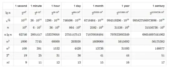

This question on cs.stackexchange has a table that is relevant to this topic. I will re-post it here for the discussion:
Required times and complexities
And a quote from the answer:
... you'd need to give an algorithm of logarithmic complexity input of size on the order of 2 to the something enormous in order to get it to run for a century, but for an algorithm of complexity $O(n!)$ you only input of size ~10 to make it run for that long.
If an there is an algorithm that provides a solution to the problem in polynomial time, in general that means the problem is solved too easily to be of use for cryptography.
