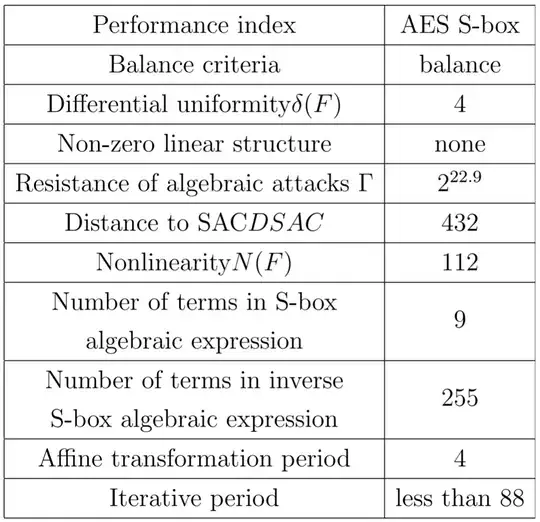

In "An improved AES S-box and its performance analysis" by Jie Cui, Hong Zhong, Wei Yang they provide the formula for calculating the above metrics, and offer a list of papers they referenced; unfortunately the first four that I searched for are paywall only. The referenced papers are probably not necessary to understand their paper or this answer.
"The cryptanalysis of the cryptographic strength of Rijndael has not stopped after the announcement and official publication of the AES $[11-16,19]$. Biryukov et al. $[10]$ proposed a distinguisher and related-key attack on the full AES-256. Wang $[5]$ noted that AES S-box affine transformation period is 4, and it does not achieve the most 16. Wang et al. $[6,17,18]$ studied AES S-box structure and pointed out that the iterative period of AES S-box has short-period phenomenon, and all the periods are less than 88. Murphy and Robshaw $[3]$ analyzed AES S-box algebraic expression and indicated that the algebraic expression of AES S-box is very simple and only 9 terms are involved. Much work has concentrated on AES S-box, such as the latest significant progress $[7]$ which illustrated the reason why AES S-box algebraic expression is so simple and proposed an improved S-box, and the algebraic expression of the S-box involves 255 terms, so the complexity of the S-box has been increased. However, the algebraic expression of the inverse S-box becomes very simple and only 9 terms are involved.
In view of the shortcomings of AES S-box and the S-box $[7]$, in this paper, the cryptographic properties of AES S-box are analyzed, and an improved scheme to increase the complexity and security of AES S-box is proposed. Simulation results show that the improved AES S-box is better than AES S-box and S-box $[7]$ in cryptographic properties.
In their paper they offer this table on page 2301:

As you can see the weakest, even stronger S-boxes, are suspicious. Belief that no one anywhere has a means to break the algorithm is probably misplaced. Some S-boxes would be more susceptible to one kind of an attack over another, so there's not one particularly strong or weak one without improvements to the original algorithm. The authors offer an improved version and their analysis of that, in addition to the original.
