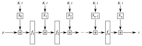

Here's a schematic drawing to better illustrate the description above:
  Schematic of an abtract rotor machine encryption process
Looking at the schematic above, you might note that it looks vaguely similar to various modern block cipher designs, such as a substitution–permutation network like AES. In fact, we can regard the abstract rotor machine described above as a kind of a tweakable block cipher operating on blocks of one symbol, with the wheel wiring $f_i$ acting as an invertible S-box (applied to the whole block at once, so that an explicit P-box is unnecessary) and the key-dependent stepping scheme serving to $s_i$ mix the initial key $K$ and the per-symbol tweak $t$ with the cipher state between each S-box application.
