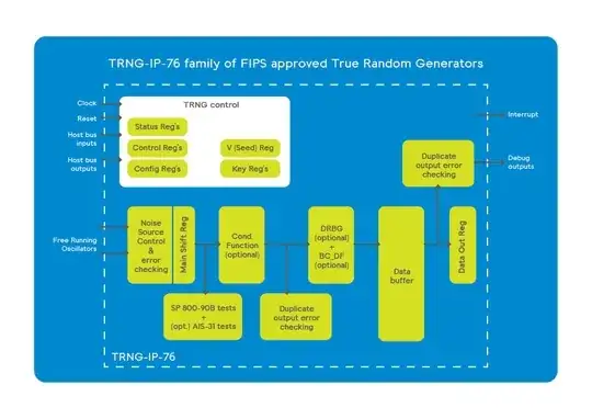

While it is not an academic research paper, here is one concrete example, the TRNG-IP-76:
TRNG-IP-76
Another example may be the ATAES132A, an encrypted EEPROM chip with its own FIPS-certified RNG. Other examples would be the main microcontroller for any number of Opal-certified storage devices, TCG-certified TPMs, various smart cards, or even your CPU itself.
