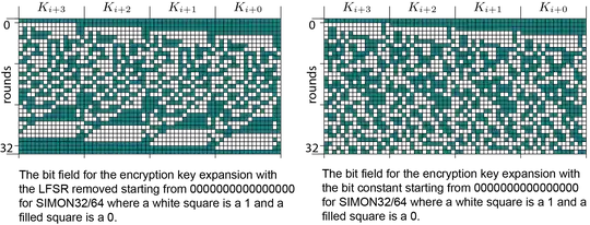

Addendum 1: I've been exploring this question a little bit as continued literature searches haven't found anything that's helpful. Slide attacks invalidate the idea that even simple round functions are strong even with many rounds. I looked at this with SIMON32/64 because it has the simplest round function that I know combined with the fact that I wrote a simulation framework for them so I could tweak the code.
Firstly, it makes me wonder why slide attacks weren't invented earlier, as the image above shows how wonderfully symmetric the simple key schedule just happens to be with the LFSR input. Secondly, as the strength of the cipher largely depends on the key rounds, it makes me more convinced that someone has looked at reducing rounds in already existing ciphers by modifying the key schedule a bit.
