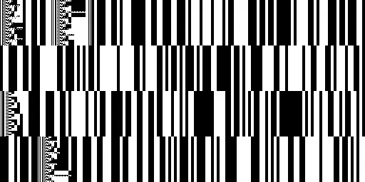

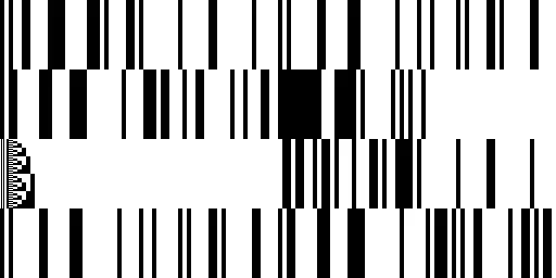

The following pictures show how quickly changes in one byte of Salsa20 input spread through the entire Salsa20 array. Here's a typical Salsa20 input array, with a superposition of 256 possibilities for the first byte in the third row:
Input
After one round:
First round

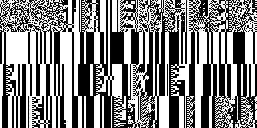

After two rounds:
Second round

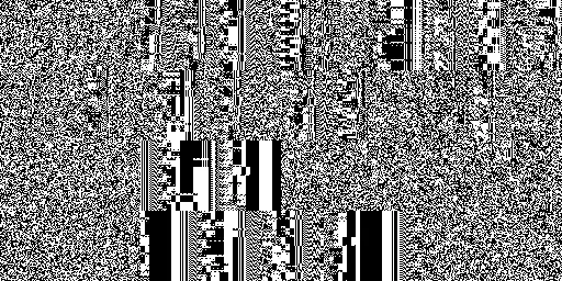

After three rounds:
Third round

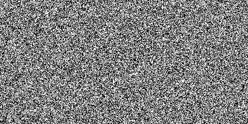

After four rounds:
Fourth round
