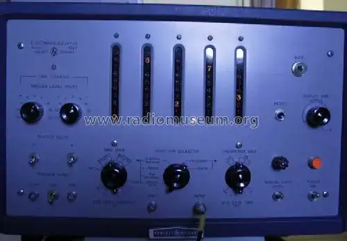

and the following is the Hewlett-Packard 522B counter instrument. You can see the random numbers on the neon display:-
counter

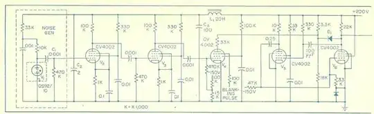

And whist the British Post Office is not the NSA, there's ERNIE which is a Premium Bond picker-outer machine. He's moved on now to solid state diodes photon counting, but ERNIE 1 (1956) did it with these valves:-
ERNIE
V1 (extreme left) is the noisy valve. Interestingly, we still use the same circuit today. We just swap the vacuum tubes for transistors.

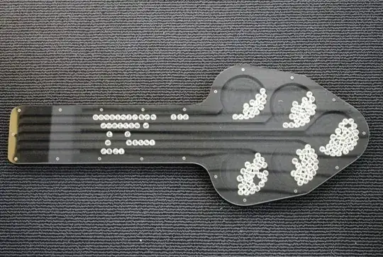

At the exhibition, besides many interesting encryption machines, a copy of the book “Achtung Spione” was on display. This book (divided in two large volumes) contains much interesting information about espionage in the early Cold War. Cryptology only plays a minor role in it. However, one picture in the book immediately caught my attention. On page 252 of the second volume the following device is shown (for copyright reasons I have to use a different picture here, but it’s the same motif):
This device is a mechanical random number generator named “Violine” (German for “violin”). It is mentioned in my book Codeknacker gegen Codemacher. The Violine was used by the West German cipher authority in the 1950s. While it is clear that this device produces five digit random numbers, I have always been wondering what exactly it was used for.
In the afore-mentioned book I found the (likely) answer. Below the picture it says: “Violine […] for the simple use of the secure encryption algorithm ‘DEIN STAR’.”
In fact, the German secret service used a manual encryption algorithm named DEIN STAR in the 1950s. DEIN STAR is a variation of the One Time Pad. It was used by spies for encrypting short messages. It was secure and didn’t require treacherous crypto devices. How DEIN STAR works is explained on Jörg Drobick’s website.
