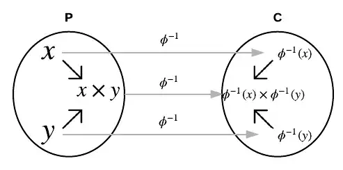

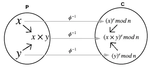

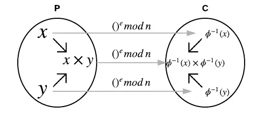

Also, trying to respect the original notation on RSA's homomorphism but emulating the figure 2.1* of the paper which of these 3 diagrams would be more correct?
HomDiag1 HomDiag2 HomDiag3
