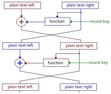

In the best maths I can manage, Feistel ≠ DES but rather DES ∈ Feistel. This is important as that's what's confusing you. It's just that DES is extremely prominent in the literature so articles are drawn towards it. The following is two Feistel rounds (ostensibly just a single round as they have to be in LH and RH pairs):-
feistel
This is also important in that this is the super set. And being so, there is no particular architecture for either the function or the key schedule that generates the round keys. DES architecture is just what the designers thought up to create it. Similarly, Blowfish ∈ Feistel, but you can come up with our own function and key schedule. I'm just a country boy and not a cryptographer, but as I understand it the overall security of a Feistel network will be proportional to the security of the key schedule times the security of function. Approximately, but you get the idea. It is possible to use anything from a strong hash function to simple compression techniques for function This will directly affect the security requirements for the key schedule.
