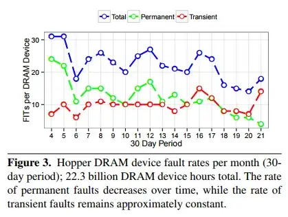

The following graph is an extract from a paper titled Memory Errors in Modern Systems. It's only one paper from many, so make of it what you will:-
FIT graph
In summary, the graph shows a monthly error rate for largish computers. You can see that per DRAM chip, the error rate is small. In one day, they got a maximum of 30 FITs /chip /month but that rate decreases with time. A single FIT is a single failure in 1 billion hours of a single device's operation. It is not 30 failures per day. So it only really matters in the exoscale machines they analysed. As your phone proves.
The upshot is that you cannot rely on errors as an entropy source as there aren't any statistically significant amounts. And if you do find some, that's an error and can't be relied upon, so you can't release code to exploit them for entropy distillation. You would have no indication of which machine had errors or how many there were. It seems from Revisiting Memory Errors in Large-Scale Production Data Centers: Analysis and Modeling of New Trends from the Field that it's very difficult to identify a machine that might be suitable for DRAM entropy extraction. They studied the entire Facebook server estate for over a year. Their findings indicate that:-

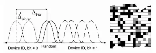

But there's at least a paper that discusses the idea of using SRAM memory contents of RFID chips just after power-on to obtain both a fingerprint of the device and some random bits.
The summary is that the SRAM cells are symmetric structures of 6 transistors, which are meta-stable at one of two configurations, 0 or 1. At power-on, the two sides of the SRAM cell compete for dominance. Which one wins depends on small intrinsic differences between the transistors, and on noise.
In some cells, these manufacturing differences dominate, and the cell reliably powers up as 0, or 1. These can be used to derive a fingerprint.
In other cells, these differences are so small that noise dominates the outcome, and these cells may power up as either value. These can be used to obtain some entropy.
This an image from the paper. On the left, 0/1 skew drawn as a diagram. On the right, a visual representation of a memory area. Black cells are bits that reliably initialize to 0; white cells reliably initialize to 1; and the gray cells may initialize to either state:
diagram from the paper
The paper is Initial SRAM State as a Fingerprint and Source of True Random Numbers for RFID Tags, by Daniel E. Holcomb, Wayne P. Burleson, and Kevin Fu.
It focuses on RFID tags (which often lack the hardware for proper RNG), but I imagine it should be viable on many other platforms. It also targets SRAM, because of its symmetrical structure. I'm not sure if the technique generalizes to DRAM or other memory types, but many computing devices contain some SRAM somewhere that may be used for this (e.g.: processor caches).
