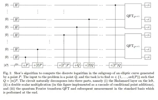

I have not found a specific answer to this question on here.
Shor's algorithm can be used to factorize a large (semi)prime $N$ by reducing the task to period-finding of a function $f(x)=x^a$ mod $N$.
This is done by creating an equal superposition over all pairs of $a_i$ and $f(x)=x^{a_i}$ for a random $x$, then measuring $f(x)$ causing the superposition to collapse into all $a_i$ for which $f(x)$ is our measures value. Using "Fourier sampling" (I have not fully understood this part) we can then obtain the period of $\ f$ and with .5 probability this yields a non-trivial square root of $N$ which leads to a prime factor.
(Plase correct me if my understanding of the above is flawed)
Now how can this algorithm be applied to Elliptic Curve schemes like ECDSA? I struggle to find an explanation for how the discrete log problem for groups over elliptic curves could be solved using Shor's.
EDIT: I would just as well appreciate a reference to other papers except Shor's, that explain the case of Shor's algorithm on DLPs.

Section 2.2 of the following paper details how to apply Shor's algorithm to ECDLP: https://eprint.iacr.org/2017/598.pdf
Shor's algorithm circuit applied to ECDLP
The process is similar to DLP, except that we need different circuits to perform our our group operations in elliptic curves (additions and scalar multiplications).
