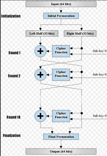

Good question and yes, it would appear that data is lost. And technically, something clearly must disappear as 6 don't go into 4. But consider the overall architecture of DES:
DES overall
Trace the flow of the left and right halves of an individual block of data. You'll see that the 2 full 32 bit words flow unimpeded down though the Feistel network. No information is lost there, it's only XORed with, maintaining the width. So 64 bits go into the block, and 64 bits emerge.

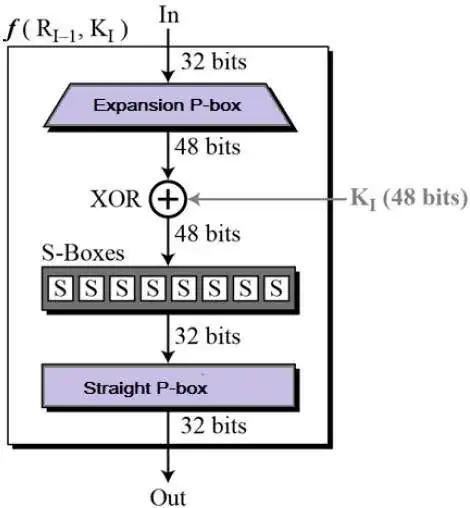

You're actually referring to the internals of the DES cipher function which looks like:-
DES function
and you can identify the s boxes. They indeed accept 6 bits and output 4, so something is lost due to the pigeon principle. But look at the expansion box above the s boxes. Additional bits are created due the permutation, P. So what is lost, never really existed but was created within (and localised to) the cipher function. So similarly for the cipher function, 32 bits go in and 32 bits come out.
