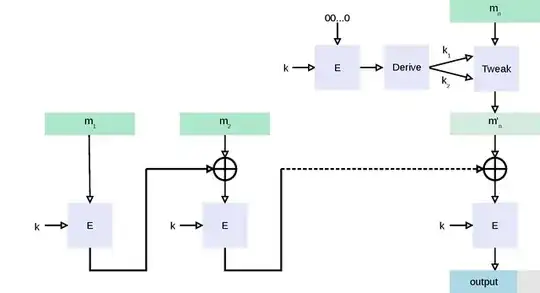

Here is the CMAC picture from Wikipedia where it is only part of the one-key MAC article:
CMAC
I don't see how it could be because it treats the last block of the message differently but this was mentioned in the comments of another question so I wanted to clarify.

Here is how CMAC works (at the end of the message, which is where the interesting part it):
  • Block $n-1$ is processed, generating an internal chaining value $I_{n-1} = E_k( m_{n-1} \oplus I_{n-2})$
  • the last block is processed; the block is zero padded (if not full), one of $k_1, k_2$ is selected (depending on whether the block is full), and we do a final computation $tag = E_k( m_i \oplus k_{1,2} \oplus I_{n-1})$
Now, we assume a full block collision, that is, $tag = tag'$. Using the above definition, we have:
$$E_k( m_n \oplus k_{1,2} \oplus I_{n-1}) = E_k( m'_n \oplus k_{1,2} \oplus I'_{n-1})$$
Removing the encryption, and noting that both sides select the same $k_1, k_2$ value, we can simplify this to:
$$m_i \oplus I_{n-1} = m'_i \oplus I'_{n-1}$$
Now, we can consider what would mapping if we compute the CMAC of the values $m || padding || x$, $m' || padding' || x$ (where $x$ is an arbitrary bits string, and where $padding, padding'$ are the zero pad to bring $m, m'$ to a multiple of block size in length; they are zero length if $m, m'$ is already a multiple of block size).
In this case, at step $n$, the two sides will compute:
$$I_n = E_k(m_n \oplus I_{n-1})$$ $$I'_n = E_k( m'_n \oplus I'_{n-1})$$
These two values are the same; the rest of the CMAC computation depends only on $x$ (which is the same on both sides), and so will result in the same tag; hence giving us another collision.
