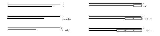

  • I noticed that:
    p - b(p - a) \mod p
    $a b \equiv p - b(p - a) \mod p$ which lead me to this little algorithm:
    $x = p - a\\ b = c / x\\ e = c \mod x\\ y = x q + e \mod p\\ y \equiv c\\ y = c - e - 1\\ b = (y * inverse(a, p)) \mod N\\ output\ b, e$
    but for whatever reason, this only seems to function when $p=65537$ and $a=256$.
    • Applying the above algorithm to a random instance of $a$ for the actual $p$ does not output $b, e$ correctly.
    • If $b, e$ were the same size as $a$, I'm pretty sure it would be information theoretically secure.
    • Since $b, e$ are smaller, it makes me think there is leakage somehow.
    • Since $a b \mod p$ is about 783 bits in size and $e$ is only about 256 bits in size, then much of the upper bits of $a b + e \mod p$ are equal to the upper bits of $p q \mod p$.
    I don't know how to take exploit this information.
The answer might be obviously simple, but I just haven't been able to figure it out for a few weeks.
