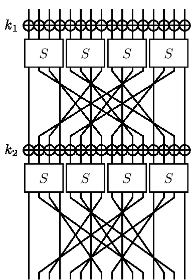

You might be interested in TikZ for Cryptographers:
PGF/TikZ is a tandem of languages for producing vector graphics from a geometric/algebraic description. PGF is a lower-level language, while TikZ is a set of higher-level macros that use PGF. The top-level PGF and TikZ commands are invoked as TeX macros. Together with the LaTeX language, it is the most efficient way to write research papers.
Here is an example of a substitution permutation network diagram that was drawn with it:
A substitution-permutation network drawn with Tikz
And here is the source that created it:
\documentclass{standalone}
\usepackage{tikz}
\usetikzlibrary{calc}
\usetikzlibrary{crypto.symbols}
\usetikzlibrary {positioning}
\usetikzlibrary{shapes}
\begin{document}
    \begin{tikzpicture}
        %% Subkey XORs
        \foreach \z in {0,...,15} {
            \node[XOR, scale=0.8] (xor\z) at ($\z*(0.75em, 0)$) {};
            \node[XOR, scale=0.8] (xorr\z) at ($\z*(0.75em, 0)+(0,-9em)$) {};
        %% Nodes positions
            \node (i\z) [above = 0.75em of xor\z] {};
            \node (o\z) [below = 2.5em of xor\z] {};
            \node (ii\z) [above = 0.25em of xorr\z] {};
            \node (oo\z) [below = 3em of xorr\z] {};
            \node (t\z) [below = 4em of oo\z] {};
            \draw[thick] (i\z) -- (xor\z);
        %% Permutation layer
        \foreach \z [evaluate=\z as \zz using {int(mod(11*\z,15))}] in {0,...,14} {
            \draw[thick] (xor\z)  -- (o\z.center)  -- (ii\zz.center) -- (xorr\zz) -- (oo\zz);
            \draw[thick] (oo\z.north)  -- (t\zz.south) -- +(0,-0.5em);
        \draw[thick] (xor15) -- (o15.center) -- (ii15.center) -- (xorr15) -- (oo15);
        \draw[thick] (oo15.north) -- (t15.south) -- +(0,-0.5em);
        %% SBoxes
        \foreach \z in {0,...,3} {
            \node[draw,thick,minimum width=2.75em,minimum height=2em,fill=white] (p4) at ($\z*(3em,0) + (1.1em,-2em)$) {$S$};
            \node[draw,thick,minimum width=2.75em,minimum height=2em,fill=white] (p4) at ($\z*(3em,0) + (1.1em,-11em)$) {$S$};
        \node[left = 0em of xor0] {$k_{1}$};
        \node[left = 0em of xorr0] {$k_{2}$};
    \end{tikzpicture}
\end{document}

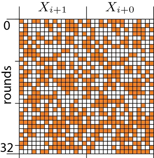

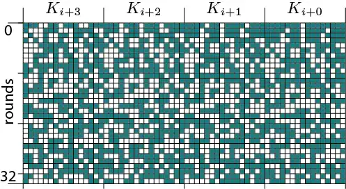

I know of no software that lets you visualize an arbitrary SPN network; however, many of us on the semiconductor side of things have their verification tools output visualizations based on the bit states. We used these to compare the SPICE output to the software simulated. My Simon Cipher and AES verification tools print out bit grids. My AES tools are async, but the simontool program gives synchronous outputs and will give you an example of how to generate these types of bit grids if you dig into the code. As a tractable example using the SIMON32/64 test vector:
simontool -e -b 32 -k 64 -s 1918111009080100 -t 65656877 -l log.e.32.64.txt -x simon-e-32-64
That dynamically creates a LaTeX file that contains a bit grid based on the input vector.
Key rounds for Simon32/64 Data rounds for Simon32/64
