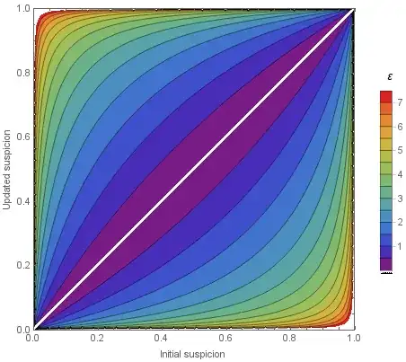

This is essentially telling us that $e^\varepsilon$ is how much confidence we can gain about whether one user has been added/removed from the data, by looking at the output. When $\varepsilon=\log(2)$, we can gain a factor of $2$ in the knowledge we have: if we had no information at the beginning (say, $P(in)=P(out)=0.5$), now we might have information like $P(in|O)=2/3$ and $P(out|O)=1/3$, but not a bigger difference.
If you want to dive a bit deeper, I wrote a blog post to elaborate a bit on this reasoning and give a concrete example. I also explain how the formula above can be used to find bounds on the possible values of $P(in|O)$ depending on $P(in)$ and $\varepsilon$:
Graph showing the posterior/prior bounds depending on ε
