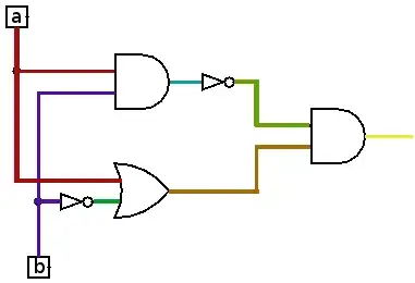

I came up with the following example, which confused me
Let's say that $a,b$ are two single digit inputs from Alice and Bob, respectively. Suppose Alice is the garbler, she garbles the above circuit and sends to Bob, along with her garbled input $GI(a)$. She then sends Bob's garbled input $GI(b)$ to Bob through obvlivious transfer. In this example, without trying to implement NOT "for free", Alice only has to send
  1. garbled circuit $\hat{C}$, which contains 7 wires (in different colors above), each with two labels
  2. .$GI(a)$
  3. $GI(b)$, and Bob can figure out the result.

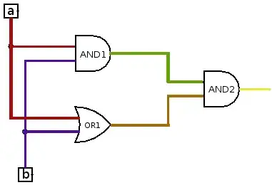

Following the first step "simply eliminating them", I remove all the NOT gates and get the following circuit
Now, AND1 and OR1 shares the same input from $b$. No matter how I invert the wire's value, the circuit will not represent the same function as before.
It seems now I have to separate the inputs for AND1 and OR1, and then give them different labels, although they came from a single source in the original circuit. Then the circuit would still have 6 wires, which isn't quite "free". If it was free, shouldn't we be able only to use 5 wires to construct the ciruit?

Regarding the NOT gates in your example. Suppose the wire called $b$ has wire labels $B$ for false and $B \oplus R$ for true. Then you would garble gate "AND1" using these labels as normal, and you would garble gate "OR1" imagining that $B \oplus R$ means false and $B$ means true.
There are two equivalent ways to think about this. One is to consider the output of the NOT gate to be a separate wire (separate from the input to the NOT gate). If the NOT gate input wire has labels $A, A\oplus R$ then the output wire has labels $A \oplus R, A$.
The other way to think about it is to absorb all NOT gates into their neighboring AND/OR gates. In your example we could garble a NAND for gate AND1 and we could garble a gate $(x,y) \mapsto (\lnot x \lor y)$ for OR1. The way to actually do this is the same as above, just let the garbler switch the "meaning" of the two wire labels, locally for this gate.
