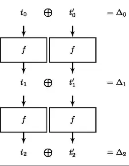

The main idea behind these attacks relies on Differential cryptanalysis. You have two inputs $t_0$ and $t'_0$ with a difference of $\Delta_0$. Once these two inputs have gone through the function $f$ (the compression function in the case of SHA-1) you get a difference $\Delta_1$ and so on (see following picture)...
The goal here is to find a difference in the input $\Delta_0$ such that after some iterations you get $\Delta_2 = 0$, in other words no difference.

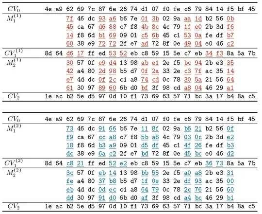

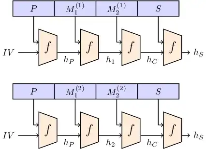

Because of the Merkle–Damgård construction of SHA-1, one can choose to alter the differences between the iterations in order to improve the differences to match his needs. In the case of the SHAttered Attack, they chose an initial prefix ($P$), then later on the next blocks they introduce a difference ($M^{(1)}_1$,$M^{(2)}_1$) and remove it ($M^{(1)}_2$ and $M^{(2)}_2$). At this point they already have their collision. They just need to continue with the same following blocks ($S$), leading to a collision on the whole input.
$\mathrm{SHA-1}(P||M^{(1)}_1\mathbin\Vert M^{(1)}_2\mathbin\Vert S)=\mathrm{SHA-1}(P||M^{(2)}_1\mathbin\Vert M^{(2)}_2\mathbin\Vert S)$
The values of $M^{(1)}_1$, $M^{(2)}_1$, $M^{(1)}_2$ and $M^{(2)}_2$ are as follows:
The difficulty is thus to find the correct $M_i$ that satisfy the chosen prefix criteria $P$ and that cancel themselves nicely afterwards. The probabilities of such to occur are really small, thus the need of massive amount of calls to SHA-1 compression function ($2^{63.1}$).

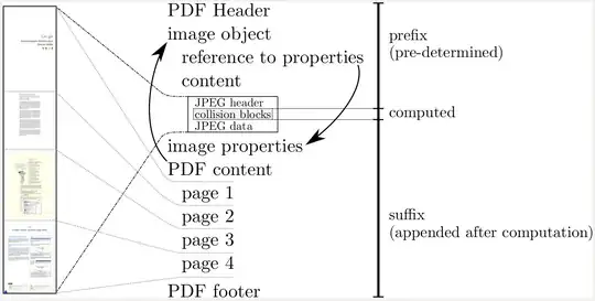

In the case of the provided PDFs, they also give a nice infographic which explain where the difference is located in the PDFs:
