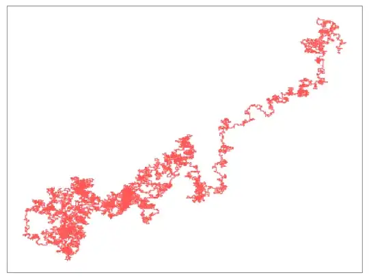

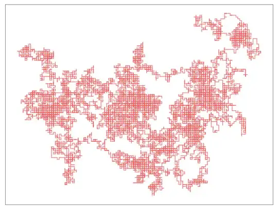

The two following random walks are from a good true random number generator. Clearly the p scores for each will be different. The first might get p << 0.05. The p score is a group operation and is only valid for that block. So the p score will vastly vary over the whole data. You might then amalgamate all the p scores together with a KS test, but then you're averaging an average and so on.
walk1
walk2
Further I don't think that anyone has studied how many ways you can park a car in a car park with that kind of focus. This test is in Diehard and only works due to computer simulation of the expected results. There may not be any simple linear relationship between car positions and entropy. It isn't a simple chi square comparison of byte values, but one of actual parked cars which have little direct relation to a p value.
Some of the other tests will be similar with mathematical simulation so the p scores relationships will be dependant on the type of test. There probably isn't the academic imperative to study this much as I'm not sure what the benefit would be.
