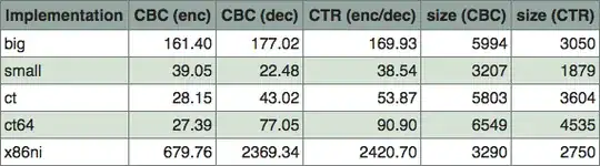

The really good point of the AES-NI opcodes is that they provide very good performance. Measures speak for themselves:
BearSSL speed/size benchmark for AES on x86_64
The AES-NI code in CBC decryption and CTR modes could be made even faster; this code processes four blocks in parallel, but the underlying CPU would be more comfortable with eight parallel blocks; OpenSSL achieves more than 4 GB/s on the same machine (but it hardly matters for SSL/TLS, since the HMAC or GHASH for integrity check will be the bottleneck).
So we can say that the AES-NI opcodes offer as good as you can get protection against side channels, in absolute terms; and they are much better than anything else on the same platform when evaluated relatively to the achieved performance. It is common to see trade-offs between security and performance in cryptographic algorithm implementations.
