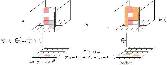

I spent quite a bunch of time to read your code and I do think that this question is in the end a bit offtopic here. So please find as follow all my remarks and code review (even though I should not...)
First, even though the way you implement it is unconventional, you are not wrong with your indexes etc... for the $\theta$ operation (it gets trickier for $\pi$ and $\rho$).
The $\theta$ step need to use two auxiliary arrays : one for the parity (your c_xz) and one to calculate the theta effect. Be sure to do that so you don't read modified values!!.
An overview of $\theta$ is the following (and for now you are in the right):
Here is my review of your code and some advises to improve, continue...
