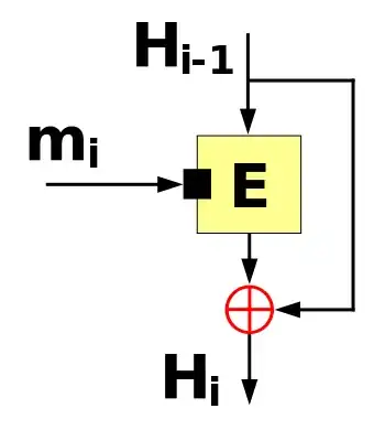

MD4 is similar to most of its successors (MD5 SHA1, SHA2) in that it's built from a Davies–Meyer compression function. There's an internal 128 bit state. To process a message block, the state is encrypted using a 128 bit block cipher keyed with the message block (512 bits --> 32bits x 16 words). To make the function one way, the input value is added to the output before processing the next block.
So, consider this a sort of fault injection attack. We get to flip bits of the round keys and see the resulting cipher-text (with the plaintext as an offset) we can vary the other message blocks to vary the plain-text that will be encrypted and then added to the result before we get it. The goal is to recover the plain-text.
