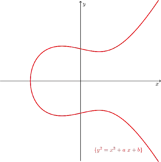

Let us consider this beautiful elliptic curve:
She is defined in a plane ($\mathbb{R}^2$).

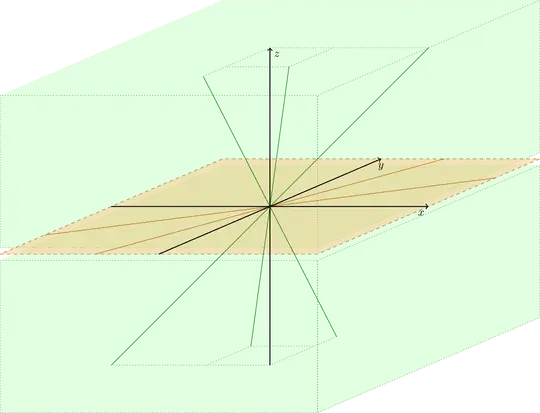

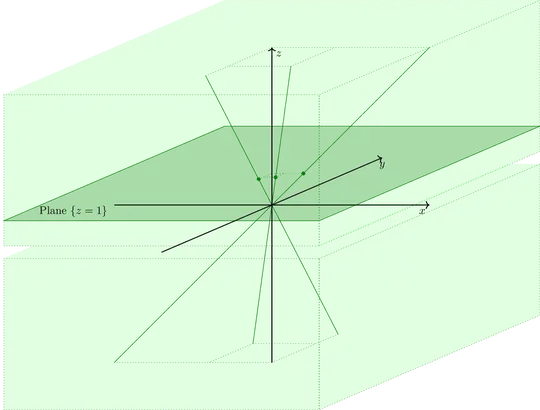

It may seem complicated so let us use some figures. Here we have a projective space.
Each points on the same green line (passing through the origin) are equivalent due to the $\sim$ relation. Each points on the same orange line (passing through the origin) are equivalent due to the $\sim$ relation.
We can divide this space into 2 sets. The points with $z=0$ (in orange) and the points with $z \neq 0$ (in green).

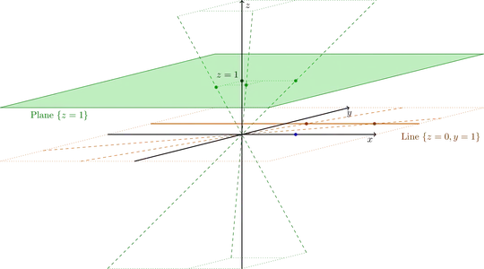

Let us have a look at the green set. If we consider the lines (or equivalent points), one can remark that they all intersect the plane $\{z=1\}$ (See diagram below). Thus all the points in the green area have an equivalent into the plane $\{z=1\}$.
The only points that does not satisfy this property are those which equivalence line is parallel to the plane $\{z=1\}$. In other words, the points where $z=0$.

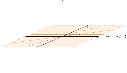

Let us have a look at those points. Using the same principle as with the green space, one can see that each line going through the origin cut the line $\{z=0, y=1\}$. Therefore with one exception, all the points in the orange plane have an equivalent on the line $\{z=0, y=1\}$.
Note that the exception are the points parallel to the line $\{z=0, y=1\}$, in other word, the $x$ axis. Because they form a line, they are all equivalent with respect to $\sim$ therefore, they are all equivalent to $(1:0:0)$.

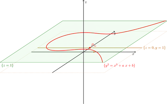

Thus, we can finally represent our elliptic curve in its projective space as bellow.

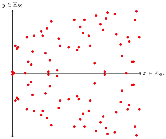

As a quick reminder, here is what a curve really looks like in a finite field: not as smooth as one would expect...
enter image description here $$y^2 = x^3 - 2 x + 1 \text{ over } \mathbb{Z}_{89}$$
