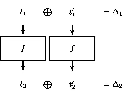

  • Differential cryptanalysis exploits the probability that a particular difference ($\Delta_1$) between inputs ($t_1$ and $t_1'$) will be propagate to a particular output difference ($\Delta_2$) enter image description here
    • By testing all the possible input differences, it is possible to return probabilities to have some output differences. A couple of specific differences $\Delta_1$ and $\Delta_2$ is called a differential and noted ($\Delta_1 \Rightarrow \Delta_2$).
    • The more likely that a given differential ($\Delta \Rightarrow \Delta'$) holds, the more effectively this behavior can be exploited against the cipher
