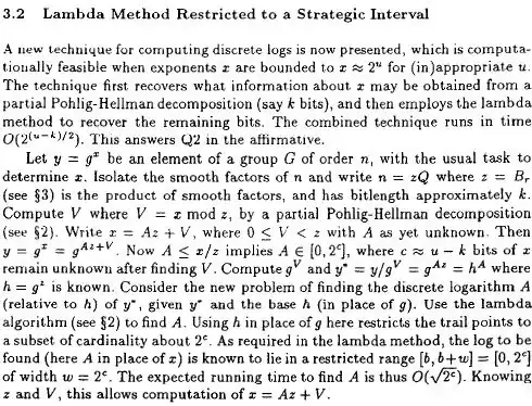

I've eventually researched this down to a further paper, as per page 338 of "On Diffie Hellman Key Agreement with Short Exponents", image below:
I can somewhat see the 'g' value required based on this, but it simply tells a user to "calculate y*", a calculation which itself appears to require several unknown values.
This could well be an issue of how I'm reading things, as I'm much better notation seen in code than in maths.
If someone could assist with what values are meant to come out of CRT and be be fed into the Pollard's Lambda function (of which there are several implementations floating around), it would be appreciated.

it simply tells a user to "calculate $y^*$", a calculation which itself appears to require several unknown values
Nope, it has $y^* = y / g^V$, where at this point, you know $y$, $g$ and $V$.
The original discrete log problem was given as $y = g^x$, and so you were given $y$ and $g$
In addition, $V = x \bmod z$, where $z$ is a smooth factor of $n$ (the group order, which the algorithm assumes you know). You can find the value of $V$ by taking the group order $n$, doing a partial factorization to obtain $z$ (even if it is infeasible to complete factor $n$, it's easy to find the small factors of $n$), and then by solving the Discrete Log problem $y' = g'^V$, where $g' = g^{n/z}$ and $y' = y^{n/z}$. This particular Discrete Log problem can easily be solved by the Pohlig-Hellman algorithm, as $g'$ is in a subgroup of order $z$, which is smooth.
