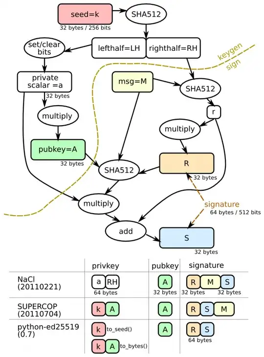

If you can store the private key with some pre-computed work, then you can pick almost any public key you want. So in a way, it depends on the implementation.
Here's a diagram of how Ed25519 works, note how keys are generated:
(Image source.)
A more detailed description (that is simpler than the actual paper) of the process is in these slides (slides 9 - 11).
To recap the image and slides: The secret is hashed and public key is derived from the "left half" of the hash. The left half is manipulated to be value $a$, which is a bit string with a few conditions. Then $a$ is applied to a curve point $B$ to produce the public key $A$.
The critical thing to note is that the seed's hash output is used in key generation. Apparently implementations differ on what they store as the private key, but the algorithm itself does not need the original secret, only the hash from it. This means that if you control the implementation you use, you can just make up any hash that suits your purposes and you don't need to care what the corresponding secret would be. (This prevents the need to finding any sort of SHA-512 pre-image.) We can use this by working backwards from the desired public key value and deciding what hash value we want.

This all assumes you can control the implementation and solve the necessary discrete logarithm. Regarding the implementation, the NaCl project has a high-speed performance-oriented implementation of Ed25519, and as such it stores as much pre-computed data as possible in the private key. It would allow you to perform this sort of manual crafting of the keys. But in general, with other implementations, you may have no such luck. I would think that for most attacks, the attacker should be assumed to be able to choose the implementation they use.
