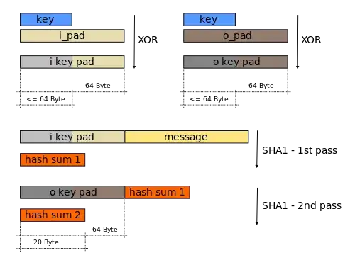

The recommendation for HMAC is (indeed) that the key size is identical to the output size (and the intermediate state for Merkle–Damgård based hashes). Now lets presume that the characters in the key are completely random and that a large enough alphabet is used, say base 64. In that case you'd have 32 * 6 = 192 bits of randomness. That's larger than the required 160 bits of randomness.
If we'd use a single byte per character encoding such as ASCII or Windows-1252 then you'd get 32 bytes. This is much smaller than the ipad or opad used in HMAC. This means that additional hashing is not required before XOR'ing the key with ipad or opad. You would even be able to use UTF-16 as long as you don't use characters that require more than 2 bytes to encode. Anything longer than 64 bytes will require an additional hash calculation.
HMAC with SHA-1 as underlying hash, from WikiMedia (thanks Gdrooid)
Below the security requirements for the key, taken from section 3 of RFC 2104: HMAC: Keyed-Hashing for Message Authentication:
The key for HMAC can be of any length (keys longer than B bytes are first hashed using H). However, less than L bytes is strongly discouraged as it would decrease the security strength of the function. Keys longer than L bytes are acceptable but the extra length would not significantly increase the function strength. (A longer key may be advisable if the randomness of the key is considered weak.)
Keys need to be chosen at random (or using a cryptographically strong pseudo-random generator seeded with a random seed), and periodically refreshed. (Current attacks do not indicate a specific recommended frequency for key changes as these attacks are practically infeasible. However, periodic key refreshment is a fundamental security practice that helps against potential weaknesses of the function and keys, and limits the damage of an exposed key.)
Where H is of course the hash function, B the block size (64 bytes for SHA-1) and L the intermediate/output size (160 bits or 20 bytes).
