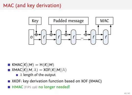

HMAC does not provide an obvious security improvement over the KMAC construction, which is optimal for Keccak based functions. HMAC is designed to create a secret initialization vector or IV for Merkle-Damgård type hash functions, KMAC does the same for sponge based hash functions but much more efficiently. HMAC also needs to deal with the length extension property
KMAC extends the key to the block size and prepends it to the message. I believe this will be standardized (if it has not already) as the default MAC construction for SHA-3. Because it extends the key to the block size, an F iteration is performed over the key prior to message absorption, creating a secret keyed state.
KMAC Slide from the SHA-3 discussion
This is the basic sponge MAC construction discussed during the Keccak design phase, and in later discussion of both Keccak and SHA-3. There needs to be some kind of encoding or padding to effectively separate keys of different sizes, but this is not discussed in those documents; the $C$ function you mention would perform such separation. KMAC as discussed during the August 2014 SHA-3 workshop shortly after the publication of FIPS 202 uses the "keypack" function to pad the key and encode the byte-length of the key block as an 8-bit value, using a minimum of 9 additional bits beyond the length of the key: $\operatorname{Keypack}(K, l) = \operatorname{enc}(l /8) | K | 1 0 ^{l-\operatorname{len}(K)-9}$ where $l$ is the block size.
The "block size" of SHA-3 is at least 576 bits for all variants, meaning a 512-bit key can key the state with only one additional iteration of $f$. Additionally, since there is no block or bit counters, a device with low computational resources but enough memory can simply keep the keyed state as its default state for MAC computations and suffer no performance hit when compared to plain hashing.
Update: Since this answer was originally written, NIST has published SP 800-185 standardizing KMAC and a few other useful Keccak-derived constructions.
