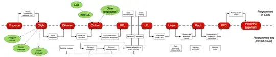

In most cases, the first method is the one used. Why? Because it is easier to start with a formal specification and then, incrementally, through proven steps, eventually get to the software (which is therefore proven). As an example, this certified compiler: enter image description here
