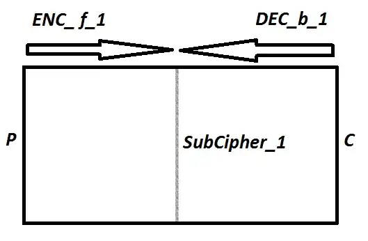

Cascading algorithms is a method of construction of bigger encryption algorithms. It is not a very good one, though. For instance, suppose that you cascade AES with another block cipher such as Serpent; or maybe you use two AES instances with two keys chosen independently. The hope may be to thereby produce a synthetic block cipher that will have twice the key length. But it does not deliver all these promises: the double-encryption method falls prey to the Meet-in-the-Middle attack (not to be confused with the unrelated Man-in-the-Middle attack). This schema may be enlightening:
Meet-in-the-Middle, from the Wikipedia page
So, by cascading two algorithms, you double the operational cost, but you do not get your money worth in security increase. To really get extra security, you must go to triple-encryption. This is why Triple-DES is triple-DES, not double-DES: the latter would not be substantially stronger than simple-DES.
