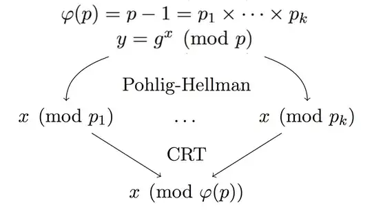

The idea is to look at a natural way of injecting a backdoor into DH with Pohlig-Hellman:
prime backdoor
Here the modulus $p$ is prime, so we can naturally compute the number of public keys (elements) in our group: $p-1$. By factoring this number you can also get the possible subgroups. If you have enough small subgroups $p_i$ then you can use the Chinese Remainder Theorem to stitch together the many partial private keys you found into the real private key.
The problem here is that, if you can do Pohlig-Hellman, it means that the subgroups $p_i$ are small enough for anyone to find them by factoring $p-1$.
The next idea is to hide these small subgroups so that only us can use this Pohlig-Hellman attack.

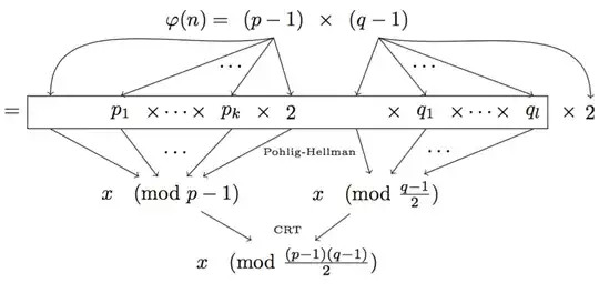

CM-HSO
Here the prime $n$ is not so much a prime anymore. We instead use a RSA modulus $n = p \times q$. Since $n$ is not a prime anymore, to compute the number of possible public keys in our new DH group, we need to compute $(p-1)(q-1)$ (the number of elements co-prime to $n$). This is a bit tricky and only us, with the knowledge of $p$ and $q$ should be able to compute that. This way, under the assumptions of RSA, we know that no-one will be able to factor the number of elements ($(p-1)(q-1)$) to find out what subgroups there are. And now our small subgroups are well hidden for us, and only us, to perform Pohlig-Hellman.
There is of course more to it. Read the paper :)
