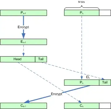

Ciphertext stealing (CS) is another alternative based on block-ciphers to produce ciphertext of the same size, but is easier to implement than FPE. Those are usually defined as extensions to non-streaming modes for block-ciphers. The Wikipedia page shows examples for ECB and CBC modes with ciphertext stealing. They can operate deterministically like FPE and the many-time pad attack as in CTR mode is not applicable. The only problem is that ciphertext stealing is only possible for plaintexts larger than a single block when the IV is static.
CS example for ECB:
