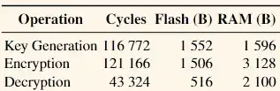

There is an alternative to ECC, called Ring-LWE, it claims to be 10x faster than ECC on microcontrollers.
details: Efficient Software Implementation of Ring-LWE Encryption
There is a C/C++ implementation here https://github.com/jnortiz/RLWE
It only implements keygen/de/encryption,
This paper contains signing/verifying Practical Lattice-Based Cryptography: A Signature Scheme for Embedded Systems
