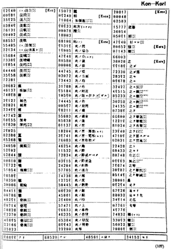

There are a number of books that discuss the Japanese codes and ciphers of the WW2 and prior era (for example, The Emperor's Codes, and Codebreakers: The Inside Story of Bletchley Park). In their case they used a number of schemes. Substitution codes (such as JN-25) would be based on words, with multiple substitutions available for each word in an attempt to reduce the possibility of frequency analysis (the words would map to 5-7 digits depending on the particular code). One snippet of a page showing the number to Japanese step is on this page. One whole page of the same step. JN-25 used groups of 5, and each group was divisible by 3 - an error correcting scheme that reduced the possible code space by 2/3, leaving only 33,333 possible code groups. The code groups would then be super-enciphered by adding numbers from another book. The main kana to code group to kana book did not change much, the super-enciphering and "formulas" for standard messages are what changed from time to time.

My understanding is that two Chinese telegraph operators, at opposite ends of a telegraph link, use two identical dictionaries with (nearly) every Chinese character printed with its corresponding 4 decimal digit Chinese telegraph code. Once a message in Chinese characters has been translated into a series of decimal digits, one can use any of the classic ciphers on them ... and perhaps translate the resulting encrypted decimal digits, 4 at a time, back into Chinese characters.
