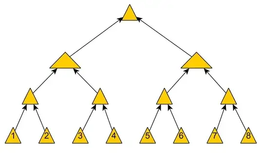

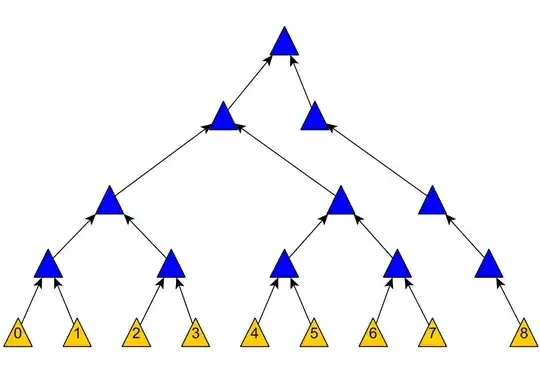

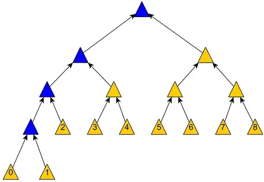

Example diagrams of the problem are shown below, showing insertions of leaf 0 at the start. Nodes requiring recalculations are in blue.
Original Fig.1 Original Tree.
Trivial insertion of data item 0
Fig. 2 Updated tree resulting from trivial insertion of leaf 0. Blue shaded nodes require re-hashing.
Ideal insertion of data item 0
Fig. 3 Updated tree resulting from ideal insertion of leaf 0. Blue shaded nodes require re-hashing.

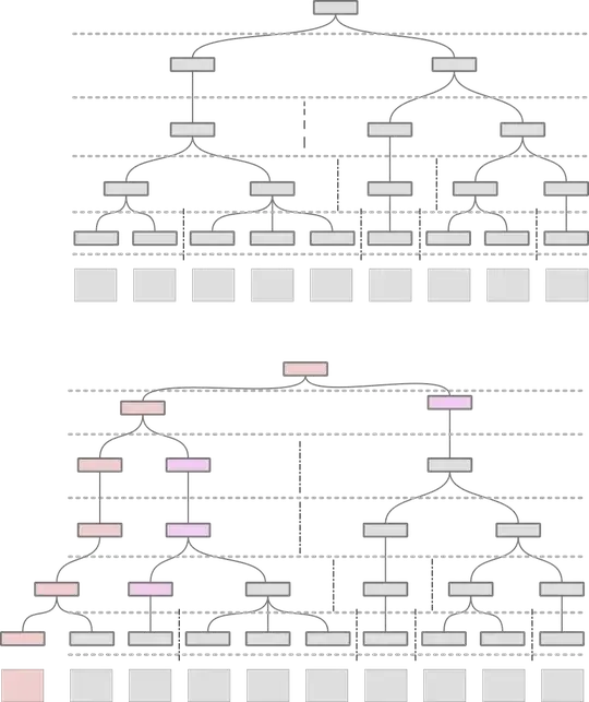

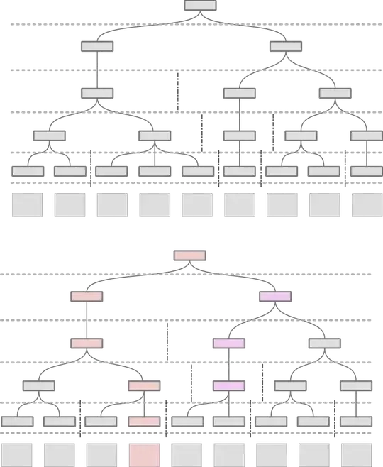

Here are some crude pictures to illustrate:
An edit to one of the underlying blocks that percolates up the hashed indicies of the tree:
An insert that causes a height change and some neighboring nodes to alter:
Red nodes are nodes directly affected by the alteration and purple nodes are ones affected by changing the boundary. Dashed and dotted vertical lines are the group boundary breaks based on hashing the nodes index values for a given (horizontal) level.
