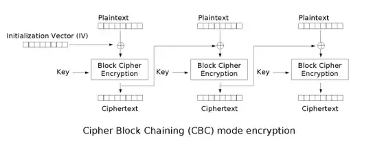

  • CBC mode is short for cipher block chaining. You have an initialization vector which you XOR the first block of plaintext against. You then encrypt that block of plaintext. The next block of plaintext is xor'd against the last encrypted block before you encrypt this block. enter image description here (Public domain image from Wikimedia Commons.)

CBC solves this by introducing a vector, which alters the first plaintext block before it is encrypted. The effect is that the entire ciphertext is randomized, as the ciphertext created by that block is used as vector for the next block (and so forth). In other words: it ensures that each block is encrypted differently even if the block contains the same information.
