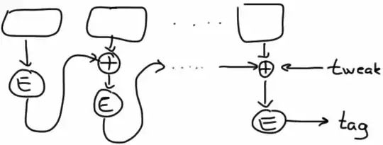

Consider first CMAC restricted to messages that consist of a whole number of blocks. Then the difference between CMAC and CBC-MAC is that CMAC xors the final block with a secret value - you could call it a tweak - (carefully) derived from the key before applying the block cipher. This ensures that the final block is treated differently from the other blocks, which in turn means that the adversary no longer has an oracle for evaluating the block cipher at values of his choice.
Simplified CMAC diagram
To make CMAC work for messages that do not consist of a whole number of blocks, CMAC (carefully) derives a second secret value. CMAC first pads the message so that it contains a whole number of blocks, then the second secret is xored with the final (padded) block before the block cipher is applied.
