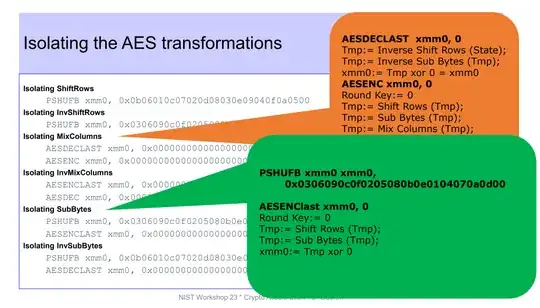

Alternatively, you can use Rijndael-256 (256 bit block size) while still using AES-NI:
It would go some ways to mitigate the problem you listed.
It's also possible to reuse the AES round function or just the s-box for a different primitive or to augment an existing one such as chacha20:
Source for the slides: https://csrc.nist.gov/csrc/media/Presentations/2023/constructions-based-on-the-aes-round/images-media/sess-5-gueron-bcm-workshop-2023.pdf
