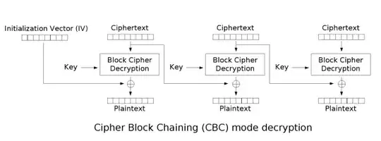

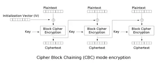

Yes, you can, but you might not be able to decrypt the first block if you don't know the IV.
CBC encryption encrypts block-by-block, using the previous ciphertext XOR'ed with the current plaintext block as input of the block cipher, the result of which form the ciphertext blocks.
So you can decrypt each block by performing the block decrypt, and then XOR-ing with the previous ciphertext block, giving you a plaintext block.
This can be performed for each block, with the possible exception of the first block, for which you need the IV. If you don't know you can try and guess the IV. If the result of the decryption already looks like plaintext then the IV is probably all zeros.
If you cannot find out any information about the IV then you're out of luck for the first block of plaintext. The reason for this is that the IV then acts as the key stream of a one-time-pad. And a one-time-pad is fully secure in a information-theoretical sense.
AES always has a block size of 16 bytes, which means that the first 16 bytes of the encrypted message might remain secret.
Note that it is quite common to prefix the IV to the ciphertext. If you cannot read the initial 16 bytes (assuming AES) then it might well be that the first 16 bytes are the IV and that the plaintext starts at the second block.
