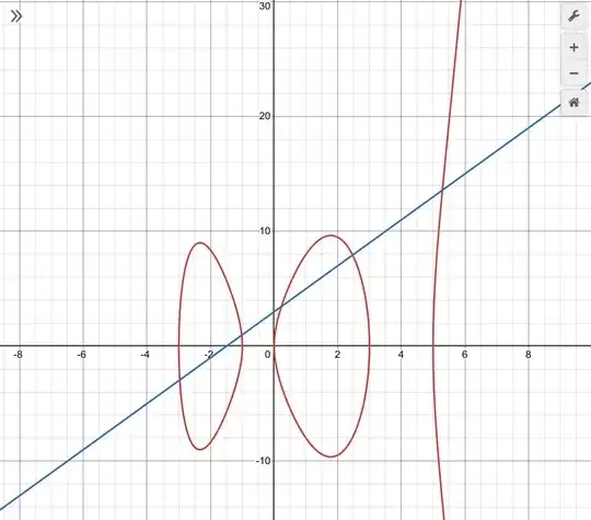

We need divisors because the calculations, precisely chord-tangent, we use to do on elliptic curve are not available to us anymore. This is because curve of genus 2 need to have odd degrees, say $deg$, greater than $3$. And we know that a line passing through any two point on such a curve would eventually pass through $deg - 2$ number of other points. This can be clearly seen in below image (a straight line, or chord, passing through a curve of genus 2) :
image of line passing through a curve of genus 2
Hence at the end divisors are just formal sum of points on curve. They allow us to add points on the hyper elliptic curve in a formal way. This can be better understood in contrast with elliptic curves.
