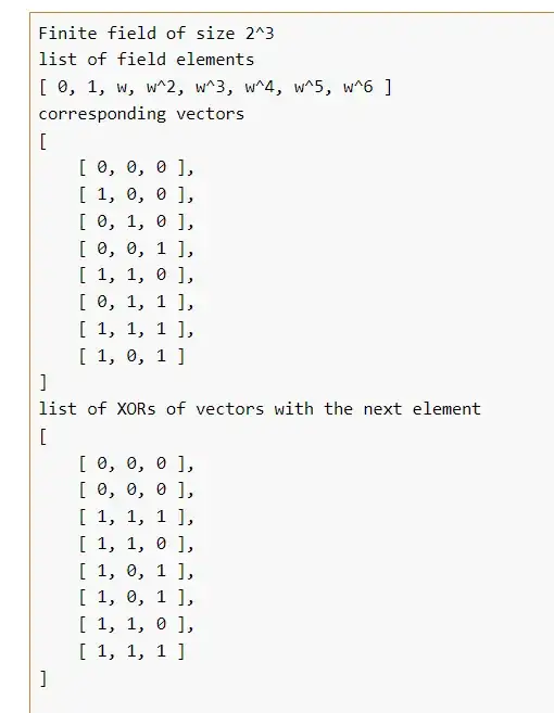

Let $U=\{v(0),v(1),\ldots,v(2^n-1)\}$ where $v(k)$ is the binary vector representing the integer $n,$ and each $v(i) \in \{0,1\}^n,$ which we can take as $GF(2)^n$ for convenience.
Almost Perfect Nonlinear functions.
A function $f:\{0,1\}^n\rightarrow \{0,1\}^m$ is APN if the multiset $$\{f(x)\oplus f(x\oplus a): x \in \{0,1\}^n\},$$ has half the possible vectors in $\{0,1\}^n$ occur twice (hence another half are missing). By symmetry if $f(x)=f(x\oplus a)\oplus f(x)$ then $x'=x\oplus a$ is also a solution of the equation so we always get 2 solutions in characteristic 2 (i.e., binary arithmetic) and this is the best possible, perfect distribution of differences is impossible in binary. That means the difference with the next value is equidistributed on half the possible values, which is quite good, since you choose the point i at random and this holds for all $i$.
Here we wish to have $n=m.$ Unfortunately, we must have $n$ odd for an APN permutation to exist. For example, the map $x\mapsto x^{2^n-2}$ which is used in AES Sbox for $n=8$ is APN for any $n$ which is odd.
Therefore, if you were ready to use $n=23$ or $n=25$ you'd be done and get the APN property.
I demonstrate this with the magma script below for $n=3$. You can run it at http://magma.maths.usyd.edu.au/calc/ I know SageMath and pari/gp can also do the same but magma is what I am familiar with. See here for more.
Since $x^7=1$ for all $x$ in $GF(2^3)$ (multiplicative group has order 7 and thus all elements have order dividing 7) the map usually shown as the inverse map for nonzero elements is actually $x\mapsto x^6.$
K:=GF(2); F:=ext<K|3>; F;
"list of field elements";
[u: u in F];
"corresponding vectors";
[Eltseq(u): u in F];
"list of XORs of vectors with the next element";
[Eltseq(u+u^6): u in F];
"permutation you want";
[Eltseq(u^6): u in F];
Output is below with probability of correctly guessing the next element being $1/2^{n-1}.$
Oops, here is the permutation you want listed:
[ [ 0, 0, 0 ], [ 1, 0, 0 ], [ 1, 0, 1 ], [ 1, 1, 1 ], [ 0, 1, 1 ], [ 1, 1, 0 ], [ 0, 0, 1 ], [ 0, 1, 0 ] ]
