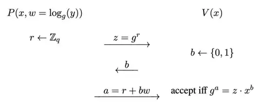

Let us recall the Schnorr Protocol, following Chris Peikert's excellent Notes on the Theory of Cryptography.
Protocol. Let $G=\langle g \rangle$ be a cyclic group of order $q$. We consider an arbitrary element $x\in G$, having Discrete Logarithm $w=:\log_g(x)$. The input to the Prover $P$ is $x,w$ and to the Verifier $V$ is just $x$. The interactive Proof System is defined as follows:

Let's denote $D_z$ the distribution that $V^*$ will use on input $z$. Let us first calculate the probability that $(z, b, a)$ is the transcript in the real world. Observe that $z$ is chosen uniformly at random by the prover, $b$ is sampled from $D_z$ by the malicious verifier $V^*$, and $a$ is completely determined by $z, b, x$. Therefore, the probability is
$$Pr[z \gets G] \times Pr[b' = b \;|\; b' \gets D_z] = \frac{p_b^z}{q}$$

In the real world, the tuple is distributed as:
  • $b$ random
  • $z$ random
  • $a$ constrained to $a = r+bw$.
Both triples have exactly the same distribution. There are different ways to see this, some more formal than the others. Intuitively, it's a combination of the following two things:
  1. $z = g^ax^{-b}$ if and only if the discrete log $r$ of $z$ is $a -bw$, that is, $r = a-bw$
  2. Sampling $r$ at random and letting $a = r+bw$ leads to the same distribution for the tuple $(a,r)$ than first sampling $a$ and then letting $r = a-bw$.
