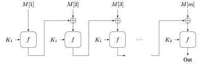

I am confused about padding when using a Message Authentication Code (MAC). This paper suggests using a different key if the message is padded, and otherwise not, which really confused me. An example is the following construction (FCBC MAC):
I want to understand padding in detail, so I will make this question bigger. I try to build it like stepping stones, so please tell me if I forget something!

Simplified, their idea is to use a key for the indomain case and a different key for the outdomain case when post-processing the CBC MAC. They call (and prove) this Three-Key Carter-Wegman Construction. Can someone explain to me why this is necessary? Why can't I use the same key for both cases (as long as they are different to the keys used before?).

ECBC MAC is only secure, if we don't pad. Otherwise, it is not secure.
I'm not reading this in John Black and Phillip Rogaway's paper (from the second author's website). My reading is that ECBC MAC is wasteful (doing one more encryption than necessary) but secure if we use Padding Method 2, and would be insecure with just Padding Method 4, but the paper introduces a variant that fixes that.
It does so by using a different key according if Padding Method 4 uses Padding Method 1 or Padding Method 2.
This is to avoid that the key used for the final block is the same for two different messages that turn identical after padding. Notice that a message $D$ with length such that $m\bmod n\ne0$, and the larger message $D'$ obtained by padding $D$ per Padding Method 1, both have identical padding per Padding Method 4. A MAC is deterministic (contrary to a Carter-Wegman MAC, which confusingly is not a MAC), so that there is no way that what happened before determines the key used for the final block.

CMAC is built from a block cipher, so at the lowest level it can only support messages whose length is an exact multiple of the blocklength. Thus, it must use a padding method to encode the input into a padded form that is block-aligned.
If the input is already a multiple of the blocklength, then any padding method will add an entire extra block of padding. The extra block leads to an extra call to the PRF, and it is natural to wonder whether this cost can be avoided. It is indeed inevitable when using padding for encryption, because the receiver must be able to unambiguously recover the original message. But in a PRF/MAC, both "signer" and verifier already hold the entire message. Their only goal is to "do something different" for all messages, which could be possible using an approach other than padding.
CMAC's approach is to use a different key when the input is already a multiple of the blocklength. It's a little bit like the following:
$$ F'\bigl(K_1 \| K_2, M\bigr) = \begin{cases} F(K_1,\textsf{Pad}(M)) & \text{ if } M \text{ not a multiple of the blocklength} \\ F(K_2, M) & \text{ if } M \text{ is a multiple of the blocklength}\end{cases}$$
So in the case where $M$ is already a multiple of the blocklength, we don't pad, meaning we don't add an extra block. Instead, we just use a different key. It's hopefully relatively clear why this construction is a secure MAC/PRF -- these two cases (what you call "indomain" and "outdomain") are handled by completely different keys.
The only problem with this simplified $F'$ is that you have to know the length of $M$ before you start, to know which key to use. CMAC gets around this because the underlying $F$ already uses 2 keys (it is a Carter-Wegman-like design), and only "finalization" key needs to change based on the two cases. So you can start the computation before knowing the length of $M$, and only at the end decide which finalization key to use based on its length.
