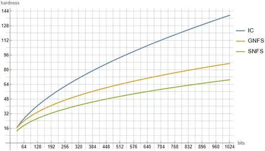

Ignoring the $o(1)$ because we lack data about it, here is a plot of the base-2 logarithm of these quantities according to bit size of $p$. Be aware that at the very least, curves are offset vertically by a considerable amount, and data on the left especially unreliable, with Index Calculus in a better position than depicted. Difficulty of IC, GNFS, SNFS
For GNFS, we get that 256-bit $p$ is approximately $2^{24.6}$ (25 million) times easier than the record 795-bit. This is to be taken with a ton of salt: it could as well be 10 million or 1 million. Still, MUCH easier. So instead of 3000 core⋅year, we are talking few core⋅hour. The effort will be dominated by getting the code running. And it's possible that Index Calculus is better from this standpoint.
