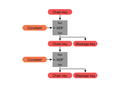

It's easier to obtain forward secrecy generally speaking. For example, compromising a state in a symmetric key ratchet could allow all future keys to be derived:
Signal protocol symmetric key ratchet
As a related aside, there was a paper recently that discusses how TMTO attacks can be applied to the TLS 1.3 key update/Signal protocol symmetric key ratchet because they can be modelled as non-additive synchronous stream ciphers. When a state is found, an attacker can derive all the future states. Because the state size is not double the key size, the protocol security level is reduced, with the amount depending on the number of updates/ratchets.

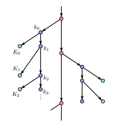

A key hierarchy
