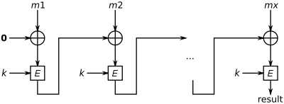

Full-State Keyed Sponge (aka Donkey Sponge) appears to cross over into block cipher mode territory such as Full Block Cipher Feedback Mode:

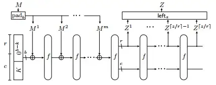

Full State Keyed Sponge (FKS) construction:
Full-State-Keyed-Sponge-FKS-construction
FKS has been shown to be a secure way to obtain a MAC.1
